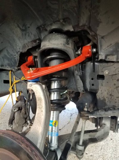

Installed the bils a week ago. Wow is all I can say. The ride is so much better in my opinion. Not exactly stiffer but it just rides smoother and firmer. It's been raining so I took it out for a spin. Set at 2.1 front with a 1" rear spacer
Just for show but the zone UCAs are freaking crazy huge and a lot beefier

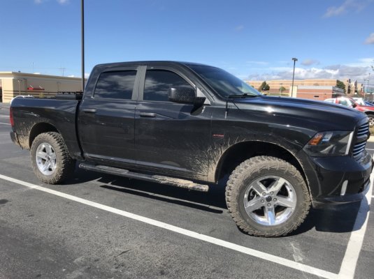

Bilstein’s at 2.8 and a 1” rear spacer with 35/12.50/20’s.
Been on the bilsteins for almost 20k Miles with no issues.

Zero rubbage. Stock wheels and a 1/4” spacer up front is all.
