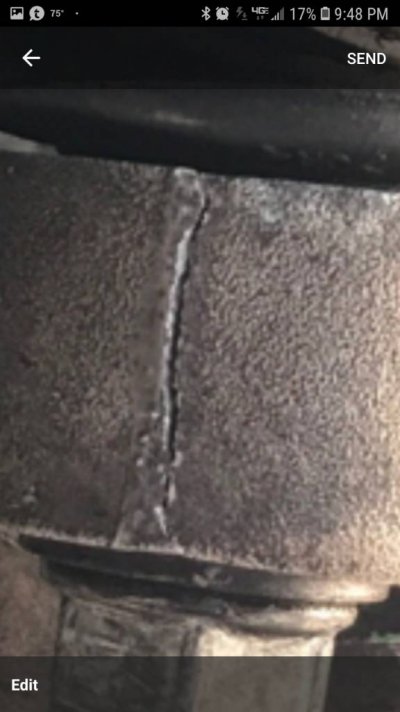

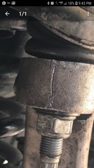

Got her all done. Had a buddy come and help. Apparently I wasn't trying hard enough because he got it loose in less then ten minutes.
I was torqueing everything up and then this happened....
Is there anything I can do about this?

Unfortunately you're looking at a new spindle. The cast aluminum can't handle the extra heat and beating on from a hammer. That's super unfortunate man, I am sorry especially after your ordeal. I would just start tearing it all back apart and get on car ID or parts geek and have one ordered tonight. I've always heard of cast splitting like yours did but have been lucky to not experience it.

The weird part is that this is the passenger side that came apart perfectly. The driver side was the step child side......
Should I just reorder a new spindle or take this up with dodge/ram?
Unfortunately it'd be a safe bet they'd deny you repair since you had it apart yourself. I'm on my phone but it looks like it cracked next to a hammer mark just to the right of the top of the crack. I'm not sure what a spindle will cost but I'd plan on doin it yourself. Unless you have a really really good dealer who can help you out most would tell you to pound salt.
Damn that's terrible !!!
Your probably on your own with this replacement ....depends on the dealer but your probably better off just changing yourself [emoji1303]c7372cb8f9c90322d6dc8ce9348c6195.jpg5bc4e72b5b47ff4069fa701cd95ef982.jpg

Pulled out my iPad, definitely looks like it cracked on a casting relief mark, coupled with a little shot from a hammer, than wedging the taper of the bj in there was the perfect scenario to spilt the cheap aluminum like dry fire wood. Fortunately it didn't happen elsewhere or was unnoticed. Granted its a defect perse, you exploited the weakness doin the modifications. They'll use that against you all day. Sure does resound the "not built like they used to" when you had cast iron knuckle you could beat all day long.

Seems like oem knuckles are still hard to find aside from direct thru mopar parts dealers. Here's a link, hopefully you can find one for a better price. Keep us posted. I know there's a vendor on this forum, can't remember who. Wish I could help more man. Especially since you're without a vehicle.

Thanks for the help gents. I had no hammer on this side what so ever. The other side looks like you'd expect. I'll be making a phone call to my dealer during work tomorrow just to see what they can/will do for me since it's less than a year old still...and fortunately we have an extra car.

If you've got no hammer marks than I'd call them definitely. The spot I'm referring to looks like it could have been a peen mark but I was building off assumption. There's no reason without doubt in my mind that this is not ok, especially with acceptable forces being applied. Level kit or not, this is a QC issue you're unlucky enough to have. It's a hard argument if it was a beat up knuckle, but if it's got no peen or marring on it, which it looks like it doesn't, id say someone better make this right. Unless you managed to torque that to 4,000,000 lb ft without shearing the bj stud lol

Thanks I'll be hitting them up tomorrow for sure! Kinda hard to just wait for them to let me know what they think. A very little part of me kinda just wants to say screw it and order another piece tonight lol
