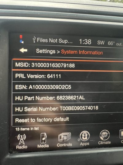

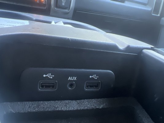

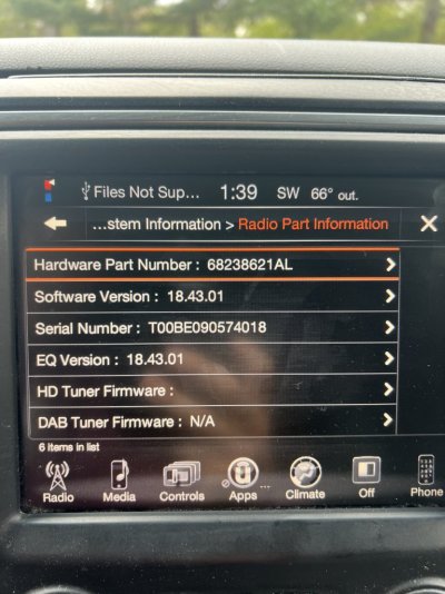

Hello all,
I’m new to this thread and am looking for a bit of help. I have a 2018 ram 1500 with the uconnect 8.4. I purchased about a year ago and haven’t been able to get the CarPlay working. I replaced the media hub, yet it still comes up as iPod when plugged in. I was reading that updating the system may fix the problem. I’ll attach pictures of info from the unit. If someone could point me in the right direction of which updates to install that would be great! (I attempted one but was given a message that the files were not supported) IMG_3786.jpegIMG_3784.jpeg

Hello all,
I’m new to this thread and am looking for a bit of help. I have a 2018 ram 1500 with the uconnect 8.4. I purchased about a year ago and haven’t been able to get the CarPlay working. I replaced the media hub, yet it still comes up as iPod when plugged in. I was reading that updating the system may fix the problem. I’ll attach pictures of info from the unit. If someone could point me in the right direction of which updates to install that would be great! (I attempted one but was given a message that the files were not supported) View attachment 564792View attachment 564793
Someone swapped a pre 2018 radio into your truck. Unfortunately, it doesn't support CarPlay.

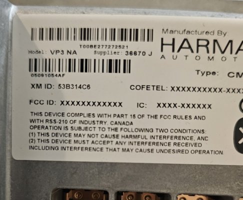

Hi guys
I have a 2013 vp3-NA, the part and serial are in the picture. I tried to update directly to the latest version that is on the uconnect website and now my radio is in a loop. It shows me the "wait 2-5 minutes" screen and the "Insert a USB update" screen. Has anyone managed to update this model? Thank you very much.

Hi guys
I had the same issue with a 2013 VP3 a long time ago. It appeared to be a driver issue and I fixed it by plugging the update USB directly into the back of the radio using this adapter.
