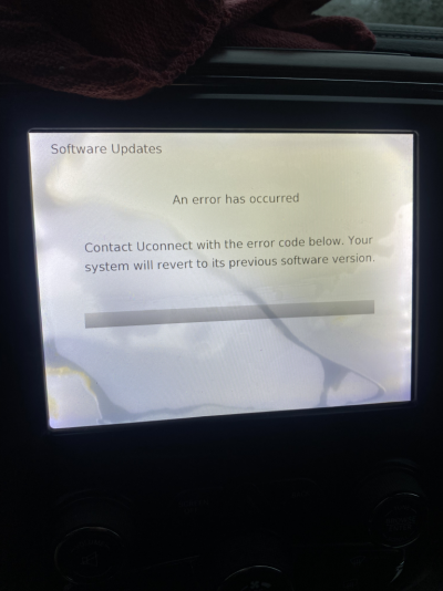

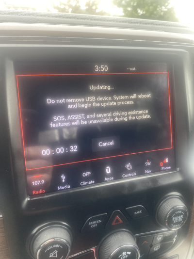

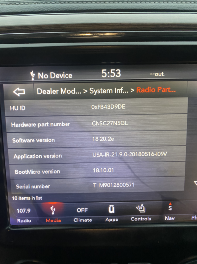

Got a new to me 2018 2500 diesel with factory radio with nav. Noticed it had version 21.9 and some GPS issues (which could be the roof antenna I suppose) so I downloaded 22.6 from post #8 of this thread and started the update following the instructions in the TSB. It gets to the screen where it says it'll take 30+minutes so I went back inside to do some stuff while it ran for a bit. Come out 15-20 minutes later to a black screen with error code 20. Its been in a loop since then. I've tried a few different versions on thumbdrives, even let is sit overnight and try to update (put it on a trickle charger). No luck.
Am I looking at a bricked radio or are there some other options available to try? I'll have to pull the radio to confirm the part # but I'm positive its factory and never been changed.
Pic of the original version, start of the update and one of a failed update. Didnt get a pic of the black screen with the error code 20 but I can as it keeps coming back.
Couple things, I have never been able to recover from an error 20 BUT others have reported success. You may have some luck with the "switcharoo" method. When the radio reboots, swap the drive with the 21.9 firmware (if you have it) or some later firmware (I wouldn't try anything past 28.3). If it continues to boot loop, leave it on the trickle charger and just let it keep going (for as long as you can).
The second thing, the screen on that radio appears to be delaminating. It can be fixed so if you recover the radio it will be another $100-$250 to replace the screen DIY (very easy to do)...
Thanks, I've tried 21.9 (downloaded from a link in ClearlyStable's thread) scratch that, file looks to be invalid. I've only tried 22.6, 28.3 and 18.14. As well as pulling the fuse, waiting for a while and trying again. What I find odd is most of the time on the white/gray screen there is no error listed at the bottom and there is no progress in the bar. I have pulled the USB on the install screen when it hits 9% (which is almost immediate most times) and it'll sit for a while then go to the white/gray screen and at that point it shows error 15. Put the USB back in and it starts showing progress on the bar but once that hits 28%, its right back to the black error 20 screen.
I can let it run for now with the truck on the trickle charger. I'll probably have to pull the fuse so its not draining the battery while at work on Mon and Tue or take a different vehicle.
I had planned on doing a DIY screen replacement for the delamination then this happened lol.
I think that 21.9 file can be used but you have to extract it with 7zip (If I remember correctly)...

No luck so far. Plugging in the USB with 21.9 the first time produced some different screen behavior but soon went back to what I’ve been seeing all along.
Assuming it’s bricked I guess my options are eBay or carport.com, well outside of the dealer. Any recommendations for a reputable source?
I'll pm you a link. Don't want to feed the resellers...
If you have time, you could always just let it continue to try to update and see if it fails through. I'm told this could be failing on the GPS/Sierra Wireless Aircard and sometimes it will eventually flash. I've seen the radio flashed after replacing the internal card (part can be found on eBay).
