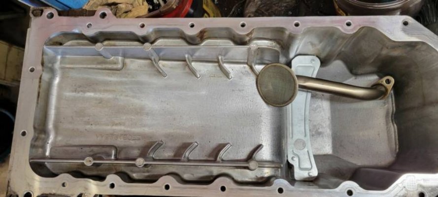

Shop pulled oil pan when doing some other work. Unbelievable what was stuck to bottom. Before and after cleaning. Has been quiet as can be since cleaning. I don't know, maybe the idle hours? Not frequent enough oil changes? It's getting them now and Mobil1. Second thing, are you all sure the better lifters (improved needle bearings) after '17? We're still having failures after.

Thanks for the suggestion... I'll try dropping the pan at the next oil change to see what state it's in before I buy everything, can't hurt. I've owned the truck since 27k and its had PUP 5w20 almost exclusively except for one stint where I tried Super Tech Advanced 5w20. Since PUP i've done 5k on M1 fs 5w40 and now its on redline 5w30 where it will most likely stay for the rest of its life.
I don't know if truck is any different but you have to dig into the front of engine (water pump, timing cover) to pull oil pan so I don't know if you want to go this far now. I suspect the police usage led to what was found in my pan. I was still amazed to see that in the pan and it was still running!!! All of it was stuck to pan and had to be scraped out but I'm sure pieces or debris had to be floating around at times and causing a roller to lock at least at times, hence the noise. Again, has not made a single lifter noise since (1000's of miles now)!
