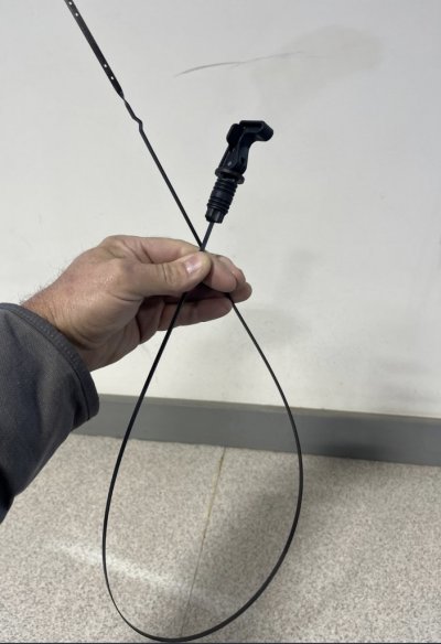

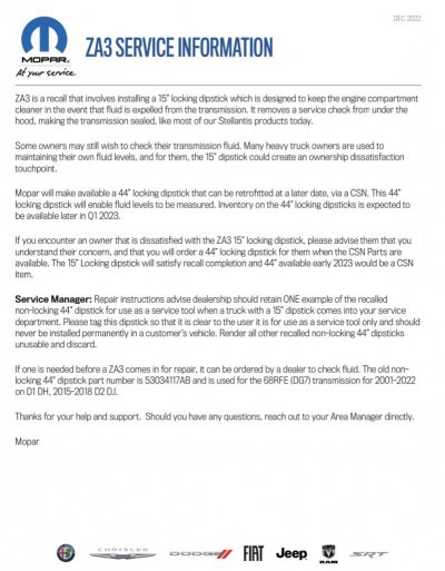

FYI, according to my dealer the longer 44" locking dipstick is NOT currently available from FCA. They are saying that they will get me one, but its not available yet?
HHank1953
Sep 22, 2022
Aurora, Co.
6.7 Diesel
Thanks for posting that letter. I am going down to the dealership and making them order this for me. Meanwhile I will still use my older dipstick to check my fluid level. This is pure you know what from the Ram people.

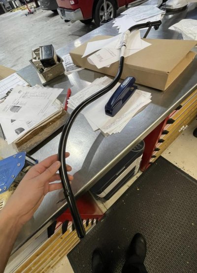

Went to the dealer today, and there was a pile of longer dipsticks on the shop floor for the recall. So I guess they have revised the actual parts now on this recall. Now if you have it done, you get the 44" long locking stick with a new tube. I had mine done two weeks ago, and so far I cant get the longer locking stick assembly, because my recall has already technically been done. RAMCARES this is really a bunch #$%it. Now the SA at the dealership are telling me, that no one really checks their own fluid levels anymore anyway, so why all the fuss? Well then why did FCA revise the parts for the recall, to include the longer stick assembly...... if there really isnt any need to check your own tranny fluid levels?
I think your dealer is full of it, I recall reading that they would replace any short dip stick for those who requested it to be done...

I just dropped my truck off this morning for a warranty job and the Service Advisor mentioned that there were a few recalls that needed to be done. I asked that they not do the locking trans dipstick recall until they can get the longer dipstick. He said that is fine, they will order the longer one, and they can't even do the short one now because they don't have parts for that, either.
