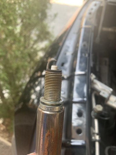

I've been getting P0306 code. I tried swapping plugs and coil to a different cylinder and drove 50 feet and it threw the code again. So I believe my next step is pulling the valve cover and checking to see if the valves open up on cylinder 6 as much as the others.
I talked to a local shop flyin Ryan recommended and they think I should do a motor swap instead of a cam swap if their is a lifter/cam failure since they don't know how far metal shavings have gotten. I understand the thinking in 10k miles I don't want to have to replace the motor or top end again.
Which route would you guys go? Thanks for any advice

Cylinder 6 spark plugs

There is no reason to throw away a good motor with a bad cam and lifters. You will already have the heads off to access the lifters. Pull the oil pan and inspect the crank and bearings for metal intrusion and go from there.
Worst case scenario you pull the motor and disassemble, hot tank cleaning at the machine shop and repair/replace any parts with damage or unacceptable wear.

You have to be specific about prices they would want motor swap versus cam/lifters job. Since you don't have to take engine out, I have to imagine a cam job would be way less. No way to know how the cam was worn, it seams like most of these show smoothed out lobes where I wouldn't worry too much about the metal. Others where the needle bearings fail have chunks of metal. It is likely either way you have been having some metal rolling around and your engine has worked just fine, only when the cam wore to a point it barely touched lifter roller did you throw a code. My vote would be cam and lifters, but yeah there is some risk. See if the dyi is a possibility, costs way less for that one.
I bet with such low miles pistons are good as is. Maybe boroscope the chamber, maybe sea foam it. Look into hemi tick threads for a lubrication strategy as well, wont do much good this time but with new cam try something different.

Absolutely try to assess motor condition 1st.....did you stop running immediately after lifter / cam failure? Or did you thump it for awhile. That determines likelihood of internal damage, and borescoping is necessary to confirm.
Cam and lifter replacement is 1/2 cost of entire engine. I have not seen failure reports on anything else on Hemi engines, so inspection is key. $4,500 versus $9,000 is a big deal. I presume it's no longer under warranty after 7 years (unless you had an extended lifetime warranty).
Also I don't recall other PUP lifter failures. With only 80 ppm moly, I assume this wasn't enough. Which is why many of us have gone to Red Line for the extra moly and clinginess of the ester base oil. And no excess idling.

I can feel the motor shaking from the misfire.
I am the original owner
I didn’t know about this being a issue til I came back to the forum. I thought it was just time for plugs or a bad coil pack, so I have driven it some including a trip from Vegas to San Jose and back for work. The engine light and code would clear itself so I didn’t think it was anything major.

It is fatal, just a matter of time. It is rare where the cam fails right away, you will get a mis fire here and there, especially when oil is hot. One of these days, likely soon, the cam lob will be worn to nub and it wont hit the lifter. It is a rather large known issue with the hemi, the fact the ride was rough will mis fire, you better plan on doing this soon if you need this as a daily. Sorry for your troubles..
