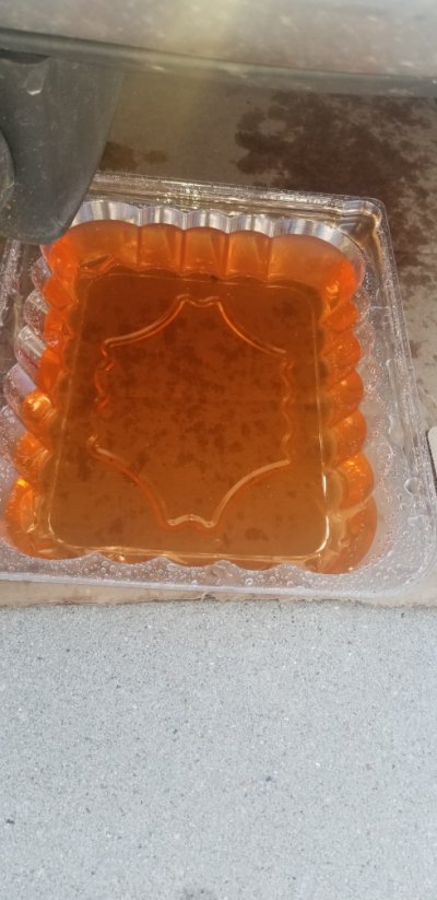

Good news is. Freaking coolant looks awesome! (Dont hate on my DOT approved coolant vessel) hahaha.
I do have pets and such. So anything that is spilled will get a good kitty litter dousing. And pressure washing after im donedcddf06d5d4c4b4927a632ae4754207a.jpg

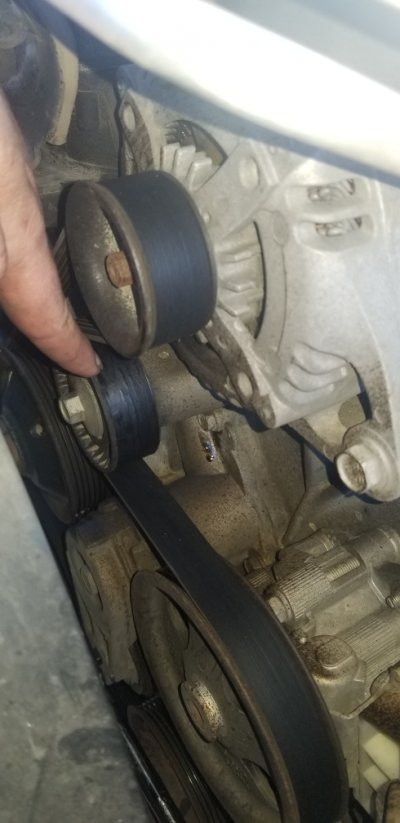

Oh, and while I'm here. This is an idler pulley right? Do we have more than one?
(Silly 4 banger home mechanic here) heheb9c28368c8d8adf63f597b033f68bc1b.jpg
