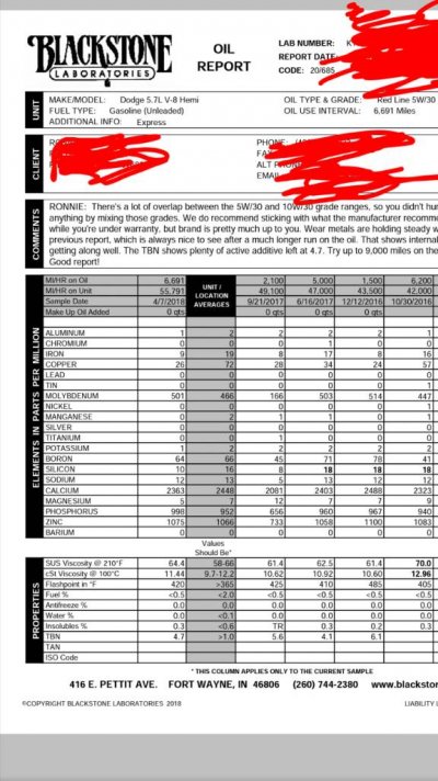

How about mixing 10-30 and 5-30 redline? Say 2 qts and 5 qts?
My last oci I mixed Redline 10W & 5W-30 at a 50/50 mix ratio and had great results with a great UOA from Blackstone .
Now I'm running 7 ea qts of 10W -30
The latest UOA on the far left dater April 2018 is the #s for the 10W & 5W mix .
Hope this helps !
My engine runs super smooth and quiet on Redline and at 55k producing pretty good wear metal results [emoji1303]
I'm at 60k now on the 10W- 30 redline and still super smooth and quiet .653c15d699131df8abb0fe7d7af43316.jpg
Hope this helps !
No issues or power loss?
