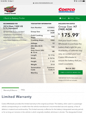

The battery group size is what determines vehicle fitment. You need a H7 (94R) battery. At 730 CCA sounds like you got the basic battery. This is similar to what you had in there from the factory OEM. Costco has AGM battery for $175.99 and $15 back when you return the old dead battery. $160 for AGM w/ 850 CCA is good. Zipcode A1A 2B2.

Hi Sheriff, Thanks for your quick response with picture.
Costco Canada had only one battery when i checked yesterday. Is H7 and price 149.99. I do not see anything else for RAm1500 in Costco Canada.

Sorry the one i got in costco is 790 cranking amps.
