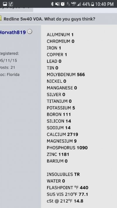

Redline 5w40 is a blue label street oil. It is good oil to. The ZDDP and clacium is a bit lower than the 5w30, 10w40 and 0w40 that i am familiar with but it still higher than all the “on the shelf oils”
Run it with confidance.

I agree, i just know that 5w30, 10w40 &0w40 have zinc and phosphorus around 12-1300 ish. Not a deal breaker but still noticeably more. The boron is there to help in the 5w40 though

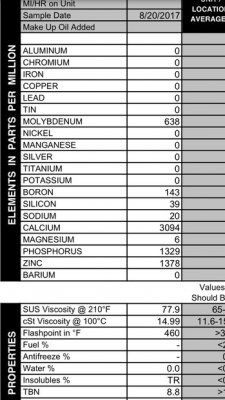

Reference 0w40

That's a fantastic looking oil , for a 6.4L Hemi
