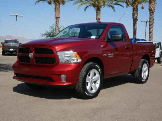

Dropped off my 2015 Ram 1500 with 8speed with 33k miles at the dealer. Noticed Wednesday that it was blowing gray smoke getting onto the freeway like a freight train. I was sitting under the freeway on Tuesday night heading home from work, man that car in front of me stinks......turns out it's me....grrrrr.
Got a call from the dealership, Transmission heater is leaking fluid onto the exhaust causing the smoke/smell.
Not covered under powertrain OR the extended warranty. FML. No way i can shell out $832 plus tax. WTF.
I have a call into warranty hoping they can help me out. Dealer said it's not safe to drive. They have my truck and if warranty doesn't help me, I am screwed.
I saw a video online showing this might be common and could just be o-rings in the tubes that connect the heater to the trans. Dealership claimed that the whole thing needs to be replaced.
Any advice / help is appreciated.4a25b2a075a30044e26e4c796eddeabb.jpg

Wonder why its not covered under extended warranty? Did they tell you why? Seems like i seen a thread on this. Seems like there may be scratches in the housing where the orings seal unit having to be replaced, but i hope you get luckier than that. Nice truck by the way!
