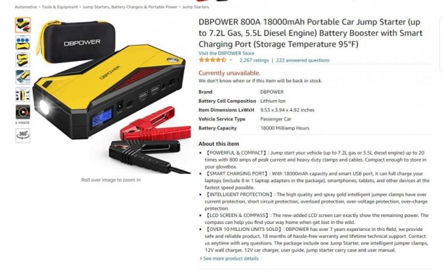

My luck with batteries is always they have show no signs of dying and then they randomly do.
YUP, 1 Minute OK, next Kaboom, sucker dead. Why when I travel I carry a jump starter, both in Truck and MC if I travel far, the old Boy Scout Motto there.
