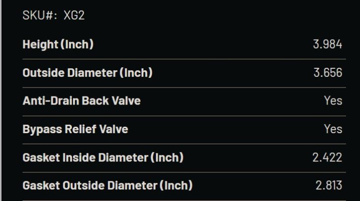

Pennzoil pp or ultra platinum is what they want you to use, that wont void warranty. If you keep getting tick, then you have a hemi tick engine, when you see they wont do squat about it it will be up to you if you want to hear it or not. Best hemi tick combo 5w30 redline paired with a royal purple 20-820 but with shortages fram ultra xg2 is suitable replacement. There is simply no replacement for redline 5w30 for hemi tick with current knowledge base, doesn't mean something else wont work, just that is the most proven. You can try lubeguard biotech which is the second best option for hemi tick, both proven with many ram forum member trucks over years and years. It has nothing to do with brand, but rather formula, those formulas are built to kill ticks, most shelf oils are not. Hemi tick is unique, so oils aren't made to address it. They tried a bit with 0w40 PUP, and somewhat successful, but most people don't want a 40 in a 5.7.
