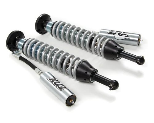

only ones I found that fox has for 4-6" lift that wont require a top spacer are the fox 2.5's and they are $1600/pair. This is the kit BDS uses.
BDS 2.5 Remote Reservoir 4"-6" Lift Coil-Overs by FOX Racing (Pair)
Fabtech also offers dirt logic coilovers with or without resi, you'll have to research the P/N and price for just the coilovers. Good way to find P/N is look at the instructions/parts list for the kits.
6 Performance System w/ Front Dirt Logic SS 2.5 Coilover Resi & Rear Dirt Logic SS Shocks- 2013-16 Ram 1500 4WD

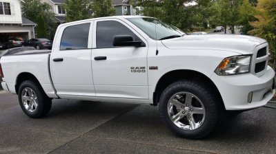

I installed rear Bils and TuffTruck progressive coils in the rear. Unloaded ride is stiffer in the rear, but same height as stock, with alot less sag on light loads. I need to put a 1" spacer on the rear left side to make up for the "dodge lean"
My front Bils are at 2.1 and the rake is perfect.

Bils at 2.1, terra grappler G2 275-65-20. I don't have wheel spacers or rear spacers. No rubbing anywhere. You could get away with 285's and have no rubbing also.
