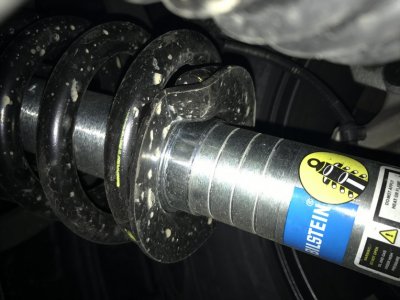

Just curious how you all were able to compress the spring enough to set it at 2.8. I rented spring compressor from Auto Zone and it was a struggle to even get it to 2.1. How'd you all do it?! Also, please see the attached pic, I think we put that metal piece on upside down?

If its upside down, thats why you had a hard time compressing the spring.
Doesn't look upside down, but it does look like a 2.8" setting?

No, the black piece aka spring seat on mine is good, I was referring to the silver piece. The one that rests on the ring where you select the notch for the height

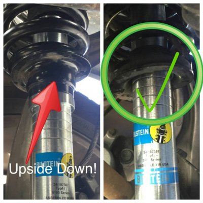

I'm referring to the piece I circled in red, it looks like I put mine on upside down
Yes, you put it on upside down. That's why you're having trouble getting the spring compressed. You need to disassemble them and flip that piece around right away to get everything sitting correctly.
Wow , I don't think I've seen thisone yet .
Definitely do not drive on that , the adjustment ring could pop out due to not being trapped & covered by the piece you've installed upside down , this could allow the adjustment ring to slide all the way down all at once .
Yup got it swapped out today and it rides much better...and safer! Guess when we did the install should have paid more attention
