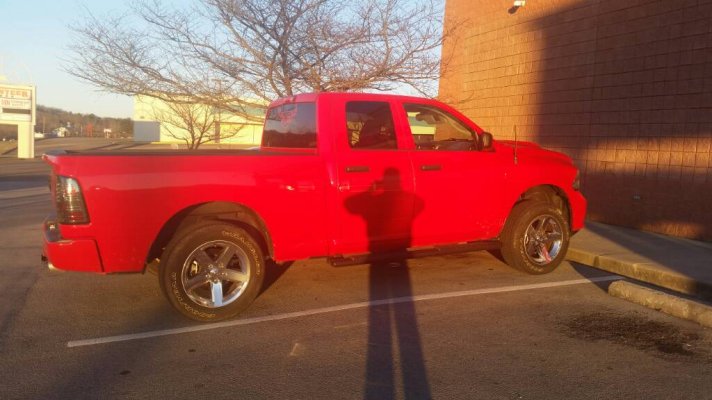

I'm certin you can pull this off , I'd go +2.8" top ring if I was you . If you end up a bit nose high its easy and inexpensive to install a rear coil spring spacer kit to get back level or a bit of + rake so you maintain level while towing .
Imo stock tires don't look too small with the bils maxed out .
See pic below ,stockers with +2.8" no spacer in the back yet .
You may struggle a bit being Navy and airplanes ,it was simple for me being Army & Helicopters. ( much more brains required ) not to mention I was born and raised in the Great state of Arkansas " Go Hogs " so it's pretty much understood I'm better looking , a hell of a lot stronger and obviously of an overall Higher intelligence than most anyone on the planet ! LOL Couldn't help myself LOL !
All jokes aside , definitely do this yourself and you'll save enough to purchase a good 12-18 vdc electric impact to help with the project and you'll save enogh $$ the alignment would be free as well .
If you run into any snags , just post up your questions & concerns with pictures here , many of us have done this and we'd be glad to have an opportunity to help out a serviceman !
