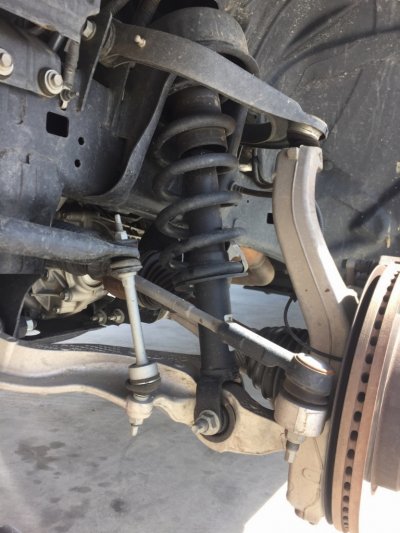

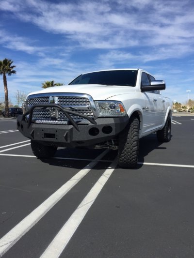

Here is my truck yesterday morning. Stock height and stock Laramie 20" wheels. 275/60r20 stock tires.
Tires off, for those interested.... Got a Bil 5100 before and after shot.

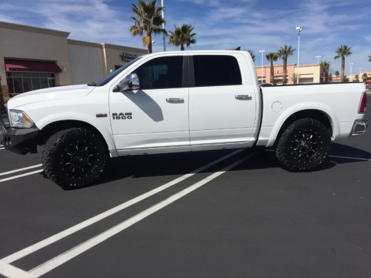

Then, finished product.

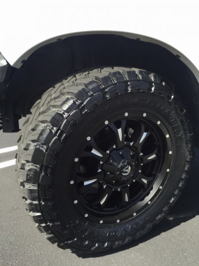

I actually had a thread earlier seeking advice on budget wheels and tires. However, tax season was very good to me this year.
35x12.5r20 Toyo Open Country M/T
Fuel racing wheels. 20x9 Fuel Kranks.

Very nice ! I really like the BUMPER !
Last tax season must've been good to ya too !
HemiPower36
May 16, 2014
1,424
839
CA
2014 Ram 1500 Laramie 4x4 3.92 8-speed
Hahaha thanks! I actually posted a thread on my bumper. I just updated it. Incase people find it on google or whatever. Just search IronBull Defender 4 if you want to check it out.
