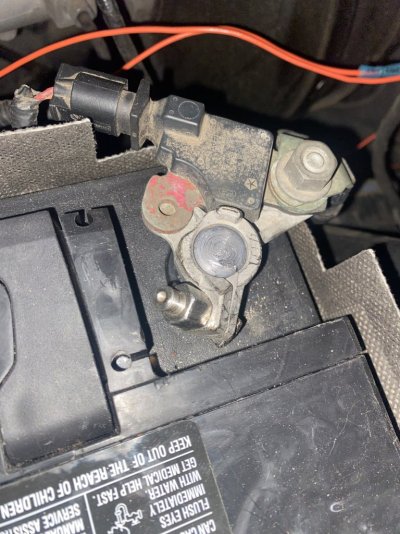

How do I remove this stuck nut on battery connector?

If you loosen the nut,and use a screwdriver in the clamp slit,and open up the slit a bit more,you'll be able to push the clamp on the post farther,then tighten the nut,you'll have a better connection . A battery post is tapered so the farther down the post you can get the clamp,the better off you'll usually be.
Ok, I will do that in the morning.

Seriously though op those bolts are really pretty soft so you should be able to use a set of vide grips and a socket to just twist it in half. As a heavy equipment operator and an avid 4wheeler I have seen lots of battery’s blow up. That’s one of the reasons an age battery is better but they are spendy. Always disconnect the cables any spark can cause an explosion. Some of the older guys probably picked up on the grinder thing. I am just a smarta$$ old fart trying to be funny.

I am not going to read all the posts,
But all you have to do to change a battery is loosen the nut a couple of turns and wiggle the terminal a bit ang pull it off
No reason to take the nut off the bolt

I see people talking about nut crackers
Really, I have never used one in all the yrs I have worked on stuff
A one off job?
Go buy a hack saw and a good quality metal blade, you can use that for lots of stuff
Hard part will be holding the cable while cutting
You should be able to get that nut to thread back down , easy if it was off the truck, a anvel and hammer

I was trying to replace the battery today when the last step was putting on the battery connectors and the negative connector bolt had a stuck nut on the end that would not come off at all. I was wondering what would be the easiest way to get the nut off of the bolt or remove the bolt and nut and replace them?
Why are you trying to remove the end nut from the post, It's not necessary. Take a screw driver and pry between both ends of the clamp and spread them apart a little to remove the post. Replace the battery and tighten the bold up and your done.
just put a small standard screw driver between the gap and spread the connector alittle
