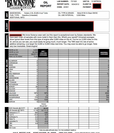

The LM stuff is a mineral oil with MoS2 in suspension. Datasheet link: https://pim.liqui-moly.de/pidoc/P000005/1011-OilAdditive-20.0-en.pdf
I am not an additive guy either but being in Europe, the Redline is for me hard to source. OTOH the Mopar 5W-20 is dirty cheap. Looking at the datasheet of Redline, it seems to be very similar to Motul X-Clean 8100 5W-30. Anyone tried the Motul stuff?
Just type Motul in the search box. It’s use has been discussed quite a few times although I don’t recall anyone using it as the vast majority of us use Redline. It does sound like an excellent oil!

I would look at the Motul 300v to compare to redline, mos2 is hit and miss at tick. I'd use Lubeguard biotech as that is the same moly in Redline and PYB, no oil uses moly in suspension anymore. A bunch of Motul have no moly in them, that is one of them. In theory the 300v should help tick similar to redline. It is a full point of operating visc lower, but it is a similar product. 300v also has a full 2 points lower hths then redline 5w30, if you can get redline it has been proven. Motul would be my second choice though, lots of moly.
