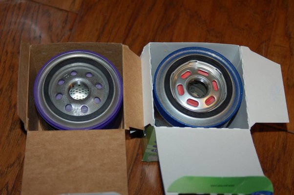

So I have done several oil changes and reported caught the tick back with a puro filter, whereas the tick was never there with RP and 5w30 with the exception of when the truck sat for a month due to the fires up here. Why I recommend RP/Amsoil filters are two fold, number one full flow, and number two it will clean as good as the day you put it on til the day you take it off proven by cutting RP filters open many times with different intervals ranging from 1 year, to 14 months, to 2 years. Use whatever filter you like, but the forum's work on the issue has RP as a good choice. Try cutting that filter open at the end of your interval, update us that. I just use an oscillating tool myself.
That particular change all I did was spin the puro off and put a RP back, and tick was gone again. I proceeded to buy a case of RP filters off amazon.
Glad the redline killed your tick, there is a lot of that going on around here. I'm not questioning your filter choice, if it work good for you. I also encourage you to look at my oil filter thread, link in my sig. See where your filter shook out in the filtering. spun microglass, full flow, great filtering, long lasting.
Burla, i dont recall, but did you cut that puro filter open ? I ask as the folks on bitog say they are prone to tearing ? Thanks.

The thing you have to be careful with is which line of Purolator are we talking about. Just like Fram, the ultra is a well regarded filter, however base model not so much.

I did not cut open puro filter because it was only on the truck for a day. I figured no reason to. That was their top of line filter. I would wager all paper filters tear when the glue that binds the paper hardens. And the paper filters don't even filter as good to start with, so literally the only reason to use a paper filter is cost, but the cheap comes out expensive in the long run imo. When the truck ticked on puro filters and not RP, I compared RP with the puro I still have. I will keep it, maybe someday I will do a quick flush and just use the puro fr a day again. This is what I've seen, there just wasn't enough holes in the puro filter for good flow. Mind you, the new puro synthetics have a cheese grater design, but regardless they have lost my business and no reason to stray from royal purple filters imo.
