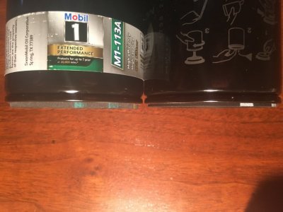

One thing about oil filters that never gets much discussion is the gasket. I never thought much about it until I had a problem with Wix xp oil filters. Now I look closely at the gasket; the Wix gasket wasn't the issue primarily but more just simply defective. With that said, M1 is my old faithful oil filter; comes with a Nitrile Gasket. It's nice and thick but pliable, see pic. Not sure if we could consider it a tier one oil filter with a blended filter media, but it's very well made. In terms of flow, I spoke to an M1 representative and they reported the M113A flows 18 gallons per minute. Not sure how that compares to the full synthetic media but respectable imo.
Here is what I found online about the gasket material:
Nitrile is highly resistant to petroleum oils, mineral oils, vegetable oils and many acids and is resistant to a broader range of aromatic hydrocarbons than neoprene. It has good elongation properties, as well as adequate resilience, tensile and compression set. These advantages make nitrile gaskets ideal for applications where resistance to oils, solvents and fuels is of critical importance, including diaphragms, hose gaskets, tubing, cups and seals for fuel and hydraulic components.

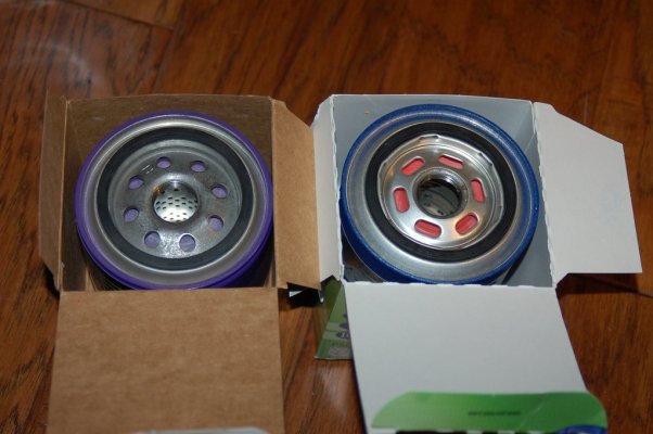

I don’t think it’s so much the filter helping the tick. I use fram filter XG16 with my relocation kit and redline 5-30 and that seemed to do the trick with the tick......
You're using a quality filter ...a quality filter DOES Make a difference imo
We here just know the RP10-48 IS a quality filter .
Don't get us wrong ...ROYAL PURPLE OILS ARE TERRIBLE !

Your using a quality filter ...a quality filter DOES Make a difference I'm
That’s what I originally went with and my tick just got louder. Drained and added redline the tick is gone
