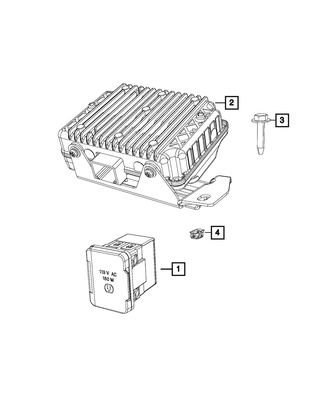

If you look at the passenger seat
Under the seat cushion, on the seat frame
( when you are sitting in the seat, reach down between your legs )
You may have a mounting point
Both my 2009 & my 2016 Rams have small inverter mounted there, it is OEM.
If you look around, either under the passenger seat floor covering or under the door sill plate, you may find unused wiring harness
It may not have power going to it, but it may only need a Fuse
Good Luck
