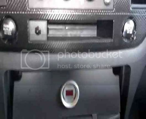

So i have troubleshot the hell out of this wideband gauge reading and it has to be wiring bc of the sensitive TIPM. Autometer sent me a new sensor, so i disconnected the sensor from the harness and left the old sensor in. Conected the new sensor and let it hang, started the truck and it read 17.0. I went inside and turn my Hellas on (which are run off a relay and triggered by a switch connected to the cig lighter) and it dropped to 14.5 just handing there in the fresh air. So i didnt swap the sensors out yet bc it has to be wiring. Also if i open my e-cutout it will also drop my readings, I have the e-cutout getting its acc power from the heated seat plug, and my afr gauge soldered to my adjustable pedals plug both options i dont have. I tested both for power with the key off and on and both read around 14v when running and 0v when off. My ground is now connected to the engine block.
After reading the schematics all if not most of the power is coming from the TIPM. So i dont know if i am overloading the TIPM or just too much connected to the same circuit. Everything aftermarket is ran with a relay, in-line fuse, and or switch. I guess my last and only option is to run my AFR 12v wire straight to the battery with a relay and switch.

Here is a short video of whats going on. When you see it drop im switching my hella fog lights on and off (they are not wired to the same power source). Sometimes when i start it up it stays at 17.0 and does not move but other times it will bounce between 15.1-17.0. But no matter the driving conditions or changing my 12v source it always stays between 15 and 17 unless i turn my fogs on it drops down to 12-13 and fluctuates and stays there untill i restart the truck then its back to 15-17 constant or 17 locked. Im lost ive done everything tech support said, got a new sensors, switched grounds and power, and even did a fresh air test and it stayed at 17 which is normal bc its pure air. What should i do? :mad: :mad: :mad:

A little update, I removed the autometer afr gauge and installed an aem wideband and it works like a charm. Before swapping them I changed the sensor and that didn't help so it was either the harness or the gauge itself. Now its time to get this thing dialed in after I get my gears installed Friday.

That sucks on how much messing with it to find out it was faulty. Gonna be cool to see what numbers you put up.
