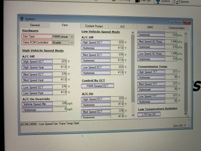

If you are using hp tuners you might be able to enable it and copy over the pwm table from a pentastart truck. That is what we did for my sierra. I know I know different maker. We modified the table from a camero and used it. The theory might work with the rams. Change the port to pwm and get the table from a pentastar truck.

When you did the swap on the Sierra did you have to do any OS segment swap or was it a matter of enabling it?

It was just a matter of enabling it and loading a temp table. as far as I can remember. I do remember it was a different port on the coming off the pcm. I had to install a wire into the harness

Well I went ahead and pulled the trigger on a new unlocked PCM from HP Tuners, in the meantime I bought the Dorman 3.7 fan and swapped my fan motor over to it with the 3.7's larger fan blade so the harness would reach. The Dorman version is better quality than the TYC that I had on my 2016, to bad the shroud was cracked right out of the box from Summit racing. Once I get the PCM installed and the unlock credits I'll mess with this more, I might just buy the 3.6 fan, enable the PWM and set the tables up just like the 3.6 Ram, I'll temporarly give the fan power and run the low speed fan relay control wire from 82 on fuse box and see if it turns the fan on.

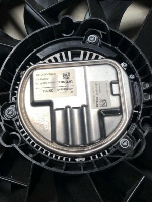

I just logged into Techauthority to look at the newer Ram to see which pin on the PCM it uses to run the 5.7's PWM fan as that is standard on the later model and it's pin 82 as well.

Humm Looking at the NBS cooling that you posted. The new fans have direct power from the battery that is not switched via relay. So it looks like they have consistent power. Port 82 is also a direct connection to the fan. The same is for the 3.6 pentastar see in the attache pic. However Port82 on the 5.7 goes through a relay. I wonder if port 82 is wired directly to the 3rd wire on the pentastar fan and the PCM is set to PWM it would work. However looking at the '17 schematic it looks like port 82 controls when the fan actually comes on. Port 78 is the one that that turns on the power to the fan??
I wonder if the reason it is not working is because of the relays being used in the '18's and below. I wonder if we set port 82 to pwm and wire it directly to the 3rd wire on the fan as well as give the fan direct power from the battery if it will work.

I have a pretty good understanding how the PWM
works and on the fuse box
I have a pretty good understanding how the PWM fan works and in the fuse box the fan has a 80 amp fuse that goes straight to the fan from battery power, the fan gets a ground from the chassis, then pin 82 comes straight from the PCM to the fan, I didn't see any relays in series with that circuit. The 5.7 circuit is using pin 82 to control the low speed fan relay that is not used but I believe is still powered, So I believe if you take 82 straight to the fan sensing circuit and then plug in the connector in the back of the fuse box for the 80 amp PWM fuse and then run to fan power and of course do the programing.

I have a pretty good understanding how the PWM works and on the fuse box
I doubt you could get a relay to switch fast enough to control a PWN fan properly, so it needs to be wired directly to the fan motor. You would need a an oscilloscope or a meter capable of reading duty cycle to measure a PWM signal. It's capable of controlling the fan from stop all the way through full speed.
The DT trucks use the same 850 watt radiator fan motor as the Gen4 EcoD, even the same 100 fuse direct from the battery.
