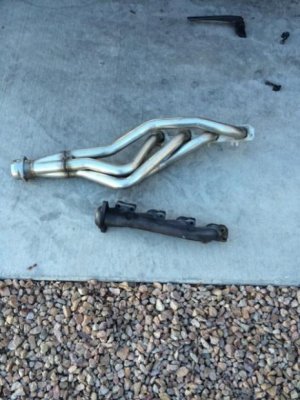

This is Why I ripped mine out at 10k and went with ceramic coated longtube headers with stage 8 locking bolts. The manifolds are tiny and cheap and also seem to be of poor design, makes sense why the my keep breaking bolts. If you do headers do longtubes you won't regret it.

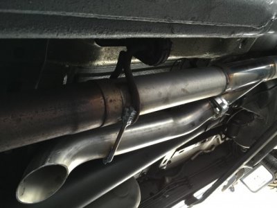

I went with ARH headers with high flow cats Moes Peformance $1500 and then had the whole system ceramic coated locally for $350. I had my local ram dealer install the headers for me no problems at all, they charged me $450. I also have it tuned Hemifever 93 octane. My dealership is very cool with mods and as long as you are not beating the **** out of it... I shouldn't have a problem. I also have a 7 yr 75000 extended warranty. All my mods have been done by my dealer including Bilsteins and zone upper control arms as well as 1.5" body lift. I also run a full catback magnaflow 16869 kit with a QTP e cutout so I can run it open headers.
