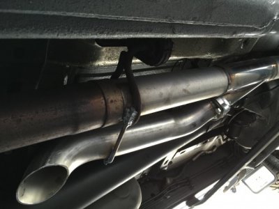

I would recommend the JBA headers they are very good and many run them on the Titians. If you can't do longtubes go with the ceramic coated JBAs! You won't regret headers much better than the stock junk. The ceramic coating is for heat reduction and flow. Stainless gets hot so it helps to cut down on the heat in the engine bay. I don't race my truck either. I just one to do things the best way possible the first time. I have been very happy with the ARH excellent quality and fitment. I also was skeptical about codes and engine lights, but no codes even without my tune. I have been running oem for past 3 weeks due to getting some work done at dealer.
I also have the magnaflow 16869 catback kit with 22" muffler and feel that the sound is perfect. I did however fully dynomat, dynaliner, and dynapad my whole interior including roof and backwall. Truck is quiet inside and not a rattle even with the 1500 watt stero and 12" sub! I installed an e-cut in that piece of straight pipe where you installed the resonator. With the cutout open truck is obnoxious! Lol
Pic below
