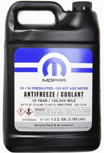

I hate to make another thread concerning the issue but is the Mopar 68163849AB the coolant that they put in these late model 1500’s? Manual says it’s the 10 year/150,000 mile formula that meets the FCA MS-90032. Or well, that’s not referring to the paper manual in my truck, this is referring to the PDF manual on the Mopar App I have. I found the stuff on Amazon but it says it’s MS-12106.
Also found it here at Moparpartscorp but the bottle looks different and from what I can see it’s the same part number and MS number. 372ab525956f28143864e73d9eaffea0.jpg

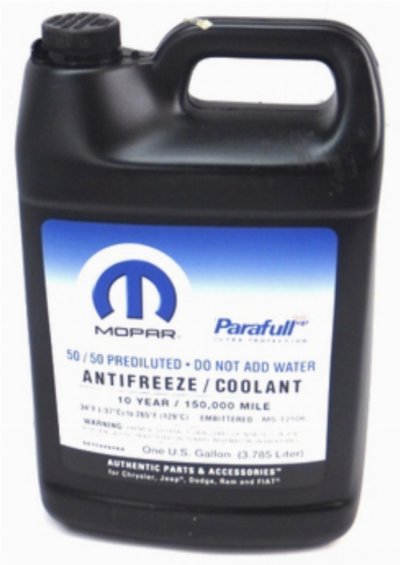

The Parafull is the name of the Fiat OAT coolant. Unfortunately Fiat's OAT coolant was the same color as the Mopar HOAT coolant.
If the jug says it's good for 10 years is the OAT coolant, HOAT is only 5 years
So in other words, even though that bottle of antifreeze that says Parafull on it is in fact the OAT formula, but the same color as the older, HOAT formula? I guess it wouldn’t matter since it’s the same stuff but I think I’ll just stick with the other that is the same color just to not arise suspicion if I have to make a trip to the dealer. The right-colored OAT stuff is purple, ain’t it? I’m pretty sure from the trace of coolant I saw on the stick this morning was purple.

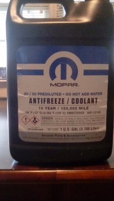

This is what I got from the dealership few months ago for my 18 Ram 1500.
I know, stupid question but that’s what the dude behind the parts counter handed you? If you don’t mind me asking, how much was it there at the dealer? I can get that off Amazon for about 23 bucks so if it’s that much cheaper, I could make a trip to the dealer next time I’m down there.
He said it's been superseded. I paid around $23 or $24 with taxes.
