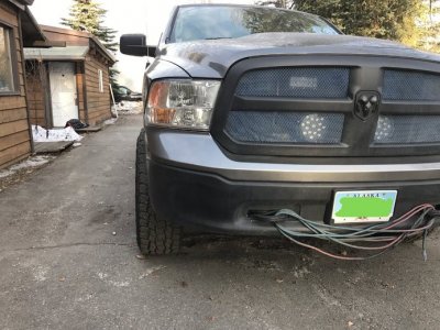

Just browsing DIYs and noticed there was no pics!
I replaced my honeycomb inserts with thin aluminum gutter screen from HD to keep bugs out. Bugs in AK are terrible, and this keeps a huge majority of them out of my radiator area. Also, took a rattle can to it so I change the accent color however often I want!
How did you attach it on?
