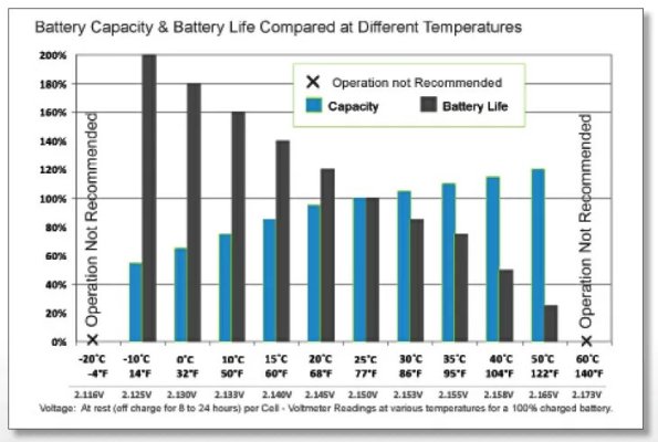

cold is good for battery life, but bad for capacity, and hemi's of course need capacity and a lot of cca. Some guys in the cold go to h8 and make them fit, the theory is a little extra capacity will let you take advantage of the cold preserving that battery.
