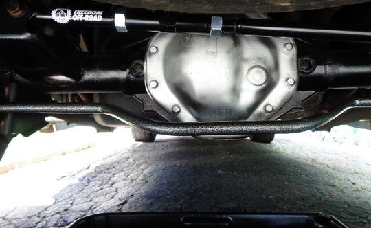

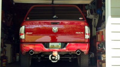

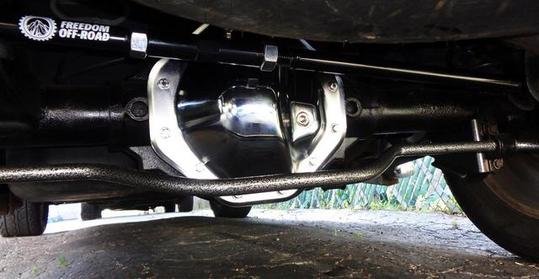

Abandoned my fantasy of converting my std. 3:55 to anti-spin because of the cost and decided to treat the gears to fresh juice instead. Just under 3 qts. of Valvoline Full Synthetic 75W-140, a LubeLocker gasket and Spectre chrome cover plus a couple of hours inhaling gear oil fumes and it's done.
Before (my paint on the cover)
During
After
I bumped the pan & spilled oil all over the moving blanket I was using, and all my tools.
Blanket, gloves & many rags all into the trash. Cleanup was massive & stinky.
The FO panhard bar is 0"- 4" adjustable and is thicker and closer to the cover.
A finned oversize cover wouldn't fit in there, the Spectre is OE style, looks good & came w/bolts & gasket (which I didn't use). The Hellwig sway bar has plenty of clearance.
