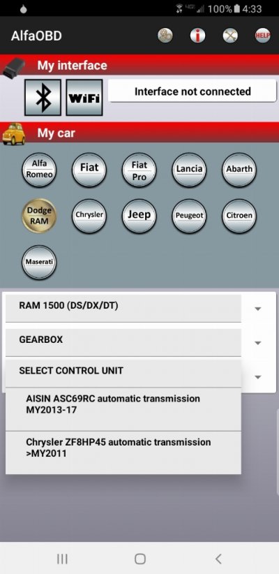

I know someone on the cummins forum has claimed it worked. I haven't tried it myself so can't say for sure?
It's under "engine" (not gearbox), then select "Quicklearn RFE"
This is good to know. My transmission has been set to quick relearn by the dealership which completely cured a rough downshift from 8-7.
Out of warranty, this simple task will cost a minimum $150 at my dealership.
